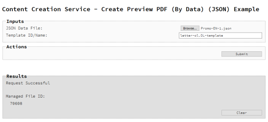

Screenshot & Output
Usage
To run the example you first need to use the Browse button to select an appropriate JSON Data File to use as an input using the selection dialog box.
Next, you need to enter the Managed File ID or Name of your template (previously uploaded to the file store) into the appropriate text field.
Once the inputs are selected/entered, select the Submit button to create the preview PDF. When the response returns, a Managed File ID of the preview PDF (in the file store) will be displayed in the Results area.
