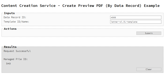

Screenshot & Output
Usage
To run the example you need to select the specific Data Record ID and the Template Managed File ID/Name (previously uploaded to the File Store).
Once the inputs are entered, select the Submit button to create the preview PDF. When the response returns, a Managed File ID of the preview PDF (in the file store) will be displayed in the Results area.
