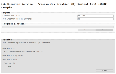

Screenshot & Output
Usage
To run the example simply enter a comma delimited list of your Content Set IDs and the Managed File ID or Name of your job creation preset (previously uploaded to the file store) into the appropriate text fields, and then select the Submit button to start the job creation operation.
The progress of the operation will be displayed in the progress bar, and once the job creation operation has completed, the ID of the Job Set created will be returned and displayed to the Results area.
