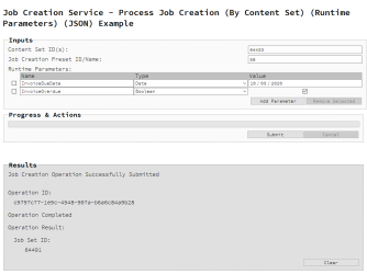

Screenshot & Output
Usage
To run the example simply enter a comma delimited list of your Content Set IDs and the Managed File ID/Name of your job creation preset (previously uploaded to the file store) into the appropriate text fields.
Next, specify one or more Runtime Parameters. Parameters can be added and removed using the Add Parameter and Remove Selected buttons respectively, and once added the following fields can be then populated for each parameter:
  • Name – The name of the runtime parameter (as specified in the Job Creation Preset)
  • Type – The type of the runtime parameter as either String, Number, Boolean or Date (as specified in the Job Creation Preset)
  • Value – The value of the runtime parameter (specific to the type selected)
Lastly, select the Submit button to start the job creation operation.
Once the operation has started processing, the Operation ID will be displayed in the Results area and the Cancel button will become enabled, giving you the option to cancel the running operation.
The progress of the operation will be displayed in the progress bar, and once the job creation operation has completed, the ID of the Job Set created will be returned and displayed to the Results area.
