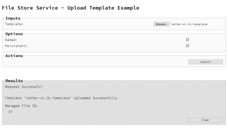

Screenshot & Output
Usage
To run the example simply select the Browse button and then select the template you wish to upload using the selection dialog box.
Next you can specify the following options to use with the upload of the template:
  • Named – allow this template to be identified/referenced by its Managed File Name as well as its Managed File ID
  • Persistent – make this template persistent in the file store
Note: Only one Managed File in the file store can be associated with a specific name. If two files are uploaded to the file store under the same name, then only the most recently uploaded file will be associated with (or can be referenced using) that name.
Once the template and options are selected, simply select the Submit button to upload the template to the server's file store and the resulting Managed File ID for the template will be returned and displayed to the Results area.
