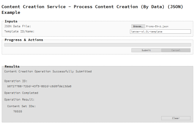

Screenshot & Output
Usage
To run the example you first need to use the Browse button to select an appropriate JSON Data File and then enter the Template Managed File ID/Name (previously uploaded to the File Store) into the appropriate text field as your inputs.
Select the Submit button to start the content creation operation.
Once the operation has started processing, the Operation ID will be displayed in the Results area and the Cancel button will become enabled, giving you the option to cancel the running operation.
The progress of the operation will be displayed in the progress bar, and once the content creation operation has completed, the IDs of the Content Sets created will be returned and displayed to the Results area.
