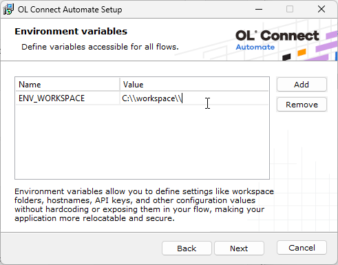

The recommended method for defining environment variables is set them during installation using the OL Connect Automate Installer. Click Add in the Environment variables window, then enter the Name and Value for the environment variable.
The environment variables screen, shown during installation, with a Name and Value set: ENV_WORKSPACE, C;\\wordpsace\

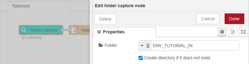

Environment variables can be used in nodes to define the full path to a folder. For example, setting a value of ENV_TUTORIAL_IN for the Folder, in the Properties of the folder capture node, point the node to the appropriate input directory.
Flow showing the Properties panel for a folder capture node. For the folder path string, ENV_TUTORIAL_IN has been entered.

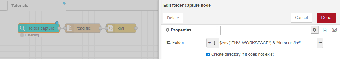

You can also use environment variables to define a workspace root, and build subfolder paths using JSONata expressions. The following example uses forward-slashes for readability:
$env("ENV_WORKSPACE") & "/tutorials/in/"
This is helpful when organizing multiple flows under a shared workspace directory. The backend automatically resolves both escaped backslashes (C:\\workspace) and forward slashes (C:/workspace), so either format is supported.
Flow showing the Properties panel for a folder capture node. For the folder path script, $env("ENV_WORKSPACE") & "/tutorials/in/" has been entered.
