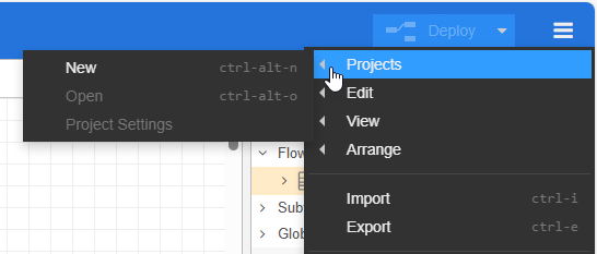

Once Projects is enabled and ready to use, the feature can be selected in the upper left menu.
The workspace menu, with Projects as an option.

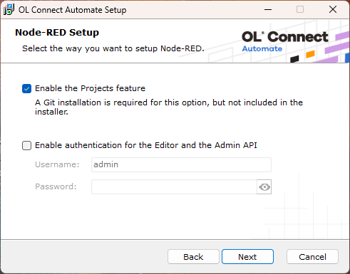

Enable Projects during Automate installation
The OL Connect Automate installer allows you to enable the Projects feature during installation. When this option is selected, the installer automatically applies the necessary settings and stores these in the olca.settings.json file.
Automate setup dialog window showing the option to enable projects.
