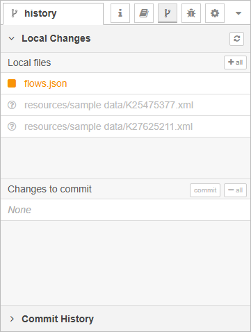

Whenever a file is modified, for example, the flow file after deploying changes or the package.json after adding project dependencies, it appears in the Local files list. If you add a file to the folder, it also appears here.
  • For text-based files, you can click the file name to view a diff showing what has changed.
  • Hovering over a file displays a + button; clicking it stages the file, moving it to the Changes to commit list.
  • Hovering over a file also displays a back button; clicking it reverts the modifications to the file, after this action is confirmed. Reverting is not available for files added to the folder.
  • Click the + button to the right of Local files to stage all files.
In the following image, the files flows.json is highlighted in orange, indicating that the contents have been modified. Two new files, shown in gray with a question mark icon, were added to the project's folder: these are sample data files within a subfolder called resources.
The local changes list, showing a modified file and two files added to the project's folder.

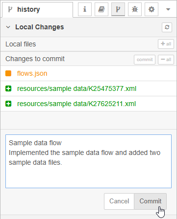

Once the desired files have been staged, click commit. You must enter a commit message to continue.
The local changes list, showing a modified file and two files staged to commit, and a commit message entered.

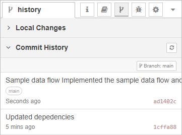

Once the commit is complete, a new entry appears in the Commit History section, showing your latest changes.
The Commit History list, with the most recent commits at the top.

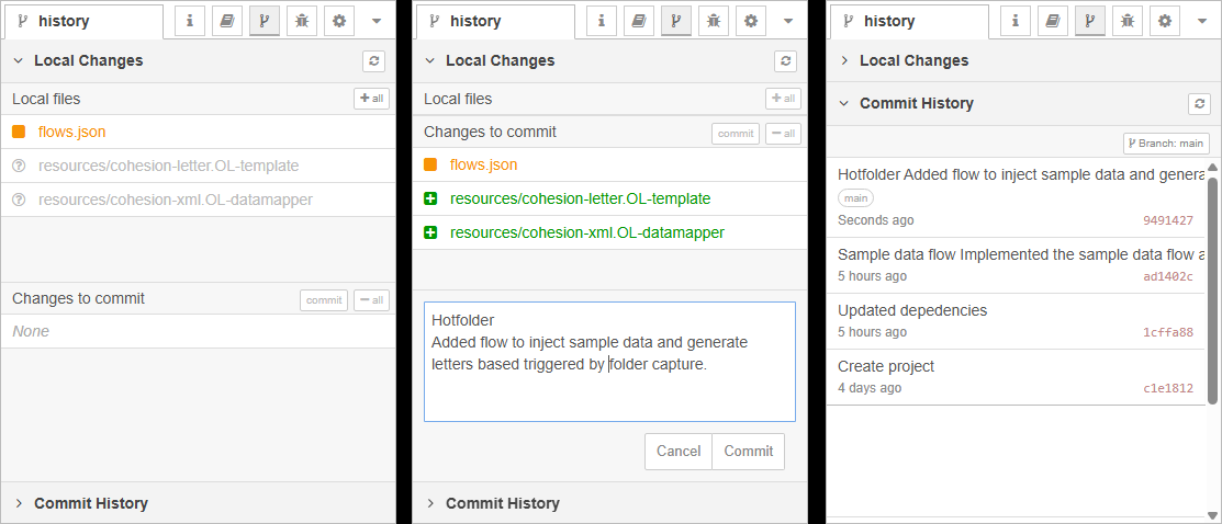

This summary image shows the Local Changes panel after modifying the flow and subflow, and adding a new template and data mapping configuration. After staging and committing these changes, a new entry appears in Commit History to record the update.
A collage of three windows, showing modified local files, staged files, and the commit in Commit History.

The Commit History section lists all of the commits in the current branch of the repository. When you create a project, the application automatically commits the initial set of default files for the project.
At the top of the list is the Branch button. That allows you to checkout or create branches within the repository.

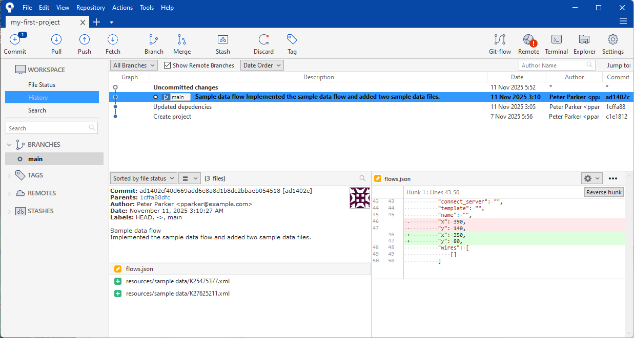

OL Connect Automate/Node-RED projects are stored as standard Git repositories, which means they can be opened and managed with any external Git client. If you need to perform the mentioned more advanced Git opererations, you can use the Git command line or a third-party Git client such as Sourcetree, TortoiseGit, or GitKraken.
The following image shows this project opened in the Sourcetree client.
An OL Connect Automate Project opened in the Sourcetree Git client.
External Git clients provide access to the full range of Git features and can also be used for everyday tasks such as staging and committing changes.
