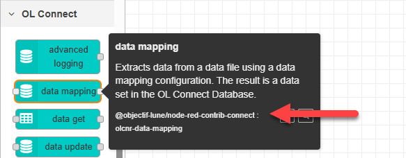

To confirm the source of a node, hover over the node in the left sidebar palette. The tooltip displays the namespace (if present), the package name, and the node’s internal name.
The following image shows the information for the data mapping node published by Upland Objectif Lune, which is part of the @objectif-lune/node-red-contrib-connect package. This is a supported node.

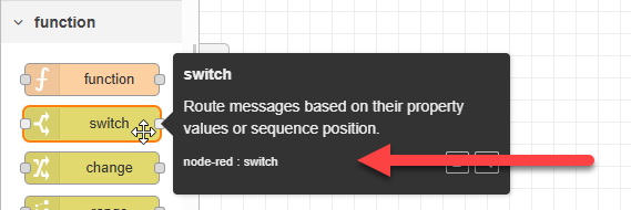

The following image shows the information displayed for the switch node, which is part of the core Node-RED package. This is a supported node.
Tooltip for a node, showing that the node is from Node-RED.

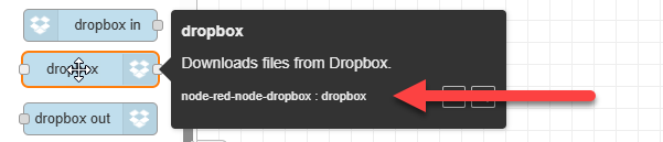

The following image shows the information for a third-party node that is not covered by Upland Objectif Lune support policies. This node is not part of the core node-red package and does not belong to the @objectif-lune namespace.
Tooltip for a node, showing that the node is from dropbox, a third-party, and therefore a node not supported by Objectif Lune.

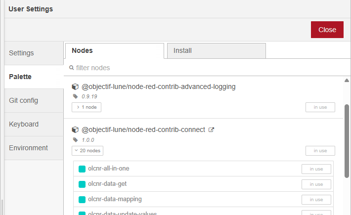

View Node Packages
To view all installed packages and their nodes:
  1. Navigate to Menu → Manage Palette and click the Palette tab.
  2. Scroll down, if necessary, to see the full list of installed packages.
  3. Click Nodes below any package to view the full list of nodes in that package.
The Palette tab of the Palette Manager, showing installed packages, and nodes for a selected package.

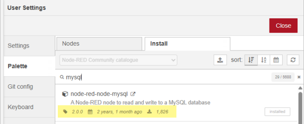

When installing third-party modules, it is important to evaluate the overall health and maintenance status of the package. The Palette Manager provides useful information to help you assess this.
Third-party modules are typically installed through the Palette Manager. Select the Palette tab on the left, then the Install tab. Use the search field to filter by name, keyword, or category. The search results for each package show the version, when it was last updated, and weekly download statistics. Additional information about packages is available on the Node-RED website.
A pacakage search result in the Palette Manager. Below the package name and description, the version, last updated date, and the weekly download statistics display.
