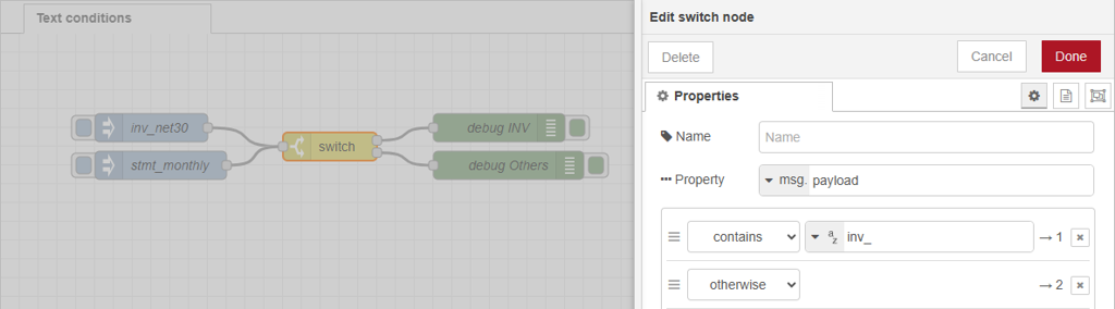

Compare the value of a msg property
In this example, the switch node evaluates the value stored in msg.payload, which contains a filename. The node is configured with two rules:
  • Rule 1: If msg.payload contains inv_, the message is routed to output 1.
    • Applies to invoice files, such as inv_net30_acc67829_20250001.xml.
  • Rule 2 (Otherwise): All other values are routed to output 2.
    • Applies to statements or unexpected inputs.
A flow with two input nodes, a switch node, and two debug (output) nodes, and the properties panel showing the entered contains condition.
This is a common and recommended pattern for text conditions:
  • The first rule captures the expected case.
  • The otherwise rule provides a safe fallback for anything that does not match.

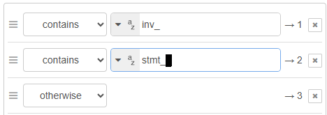

Extend the condition
Building on the flow above, you can extend the condition by adding another rule. Use Add rule at the bottom of the rule list, in the switch node Properties.
The switch node still evaluates msg.payload, but now uses three rules:
  • Rule 2: If msg.payload contains stmt_, the message is routed to output 2.
    • Applies to statement files, such as stmt_monthly_acc67829_2025_01.xml.
  • Rule 3 (Otherwise): All other values are routed to output 3.
    • Applies unexpected inputs.
Properties of the switch node, showing the two conditions set.

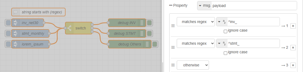

Match name starts with, using regular expression
In this scenario, the switch node rule comparison is changed to regular expression (regex). Instead of checking whether the value contains a string, the rules explicitly test whether the filename in msg.payload starts with a specific prefix.
Enter the ^ anchor character to ensure the match occurs at the start of the string. This makes the condition more precise than a simple contains check. This approach is recommended when filename prefixes have a defined structure and meaning.

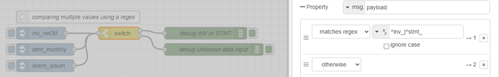

Compare multiple values using a single regular expression
In this variation, a single regex rule is used to match multiple known filename patterns and route them to the same output anchor. Any filenames that do not match the pattern are handled by the otherwise rule.
The following regular expression is used:
Copy
^inv_|^stmt_
The pipe character, |, means OR. It allows the rule to match either of the two patterns:
  • ^inv_ matches filenames that start with inv_.
  • ^stmt_ matches filenames that start with stmt_.
If either condition is true, the message is routed to the configured output. Filenames that do not start with one of these prefixes fall through to the otherwise branch, where unknown or unsupported inputs can be handled safely.
A flow with three input nodes, a switch node, and two debug (output) nodes, and the properties panel showing the entered matches regex condition.

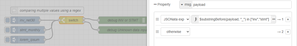

Compare multiple values using JSONata
JSONata is a powerful expression language for formatting, transforming, and combining data. Many nodes, including switch, support using JSONata to compute values at runtime. More information about JSONata is at https://jsonata.org/.
The following expression shows how to extract the text before the first occurrence of the underscore character of our file names and tests of the value exists in the array:
Copy
$substringBefore(payload, "_") in ["inv","stmt"]
There are many manipulation features in JSONata that are useful for text conditions.
A flow with three input nodes, a switch node, and two debug (output) nodes, and the properties panel showing the entered JSONata expression condition.
