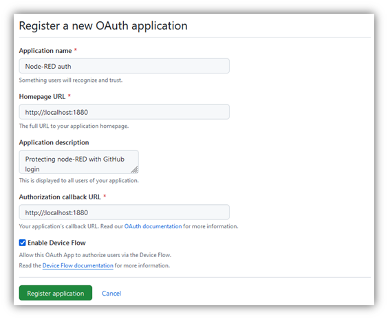

    From there you can register a new GitHub App. The following image details the required app configuration. It is important to note that the Homepage URL and Authorisation callback URL are the landing page of the Node-RED installation. This is perfectly okay when using the provided Node-RED authentication plugin.

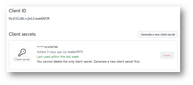

    After registering the application, go to the app's setting page to copy the client ID and generate a secret token.

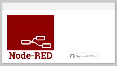

  4. If Node-RED is running, stop and restart, otherwise start node-RED. When you open Node-RED in the browser you should see, instead of the flows, a page with a login prompt.
Log in

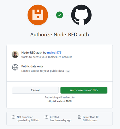

When the Sign in with GitHub button is clicked you will be taken to an external web page. The contents of this page are as illustrated in the next image.
On clicking the Authorize button, the user making the request will be authorized and redirected back to the Node-RED home page URL. If login has been successful, full access to the flows is now possible, and the icon associated with the user's GitHub account should now be visible in the right-hand side of the Node-RED top header bar.
