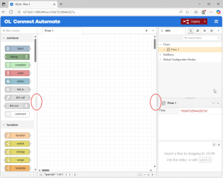

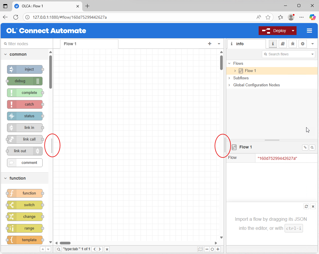

A typical workspace screen consists of a sidebar palette of nodes on the left, the workflow space or canvas, and a sidebar of options on the right.
The canvas can scroll horizontally and vertically. You can have more than one canvas, and tabs at the top identify the canvas. To add a canvas, click the plus sign, +, at the upper right of the canvas. By default, the canvases are labeled Flow 1, Flow 2, etc., but you can rename a canvas, and provide information about it, by double-clicking the tab and editing the Properties.
You can widen or narrow the sidebars by clicking and dragging on the inner edge. You can collapse or open sidebars using arrows that appear if you place the mouse over the thick line
