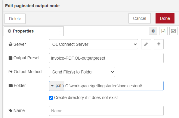

  1. Add a paginated output node to the flow after the paginated content node.
  2. Double-click the node to open its Properties panel.
  3. In the Server drop-down, select the appropriate OL Connect Server configuration.
  4. In the Output Preset drop-down, choose invoice_pdf.OL-outputpreset.
  5. Under Output Method, select Send File(s) to Folder and specify the output path in the Folder field. In this example, we’re saving the output to:
    C:\workspace\gettingstarted\invoices\out
Properties panel of the paginated output node, with entries as described above.
  1. Click Done to save your changes.

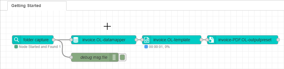

Workflow including the template for paginated output, as described above.
Generate PDF Review
When triggered, the flow will generate the final PDF output and save it to the specified folder. Depending on the Output Preset configuration, this may produce a single PDF containing multiple documents or separate PDF files when document separation is enabled.

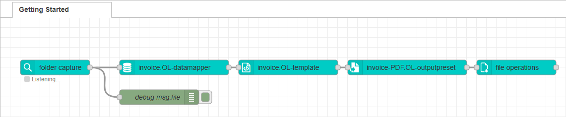

The workflow with the added file operations node, as described in the text.
