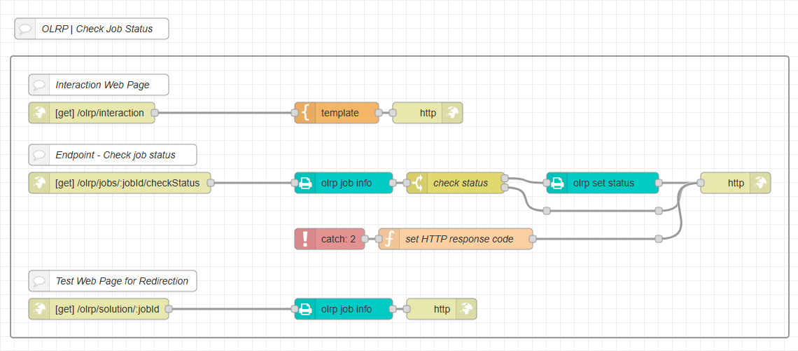

The following flows handle user-facing interaction, the job status check and a test page for redirections. The nodes that comprise the flows are described in detail below.
Busy / Processing web page flow
This shows a busy or loading screen in the user’s browser when a print job is submitted through the OL Remote Print Client in interaction mode.
Endpoint - Job status flow
This flow is called by the busy page through JavaScript polling. It queries the OLRP server to check the current status of the print job.
Test page
Displays the raw job data when enabling redirection in the template node of the Busy/Processing web page flow.
Illustration of the two workflows. The nodes and connections are described in text sections below.

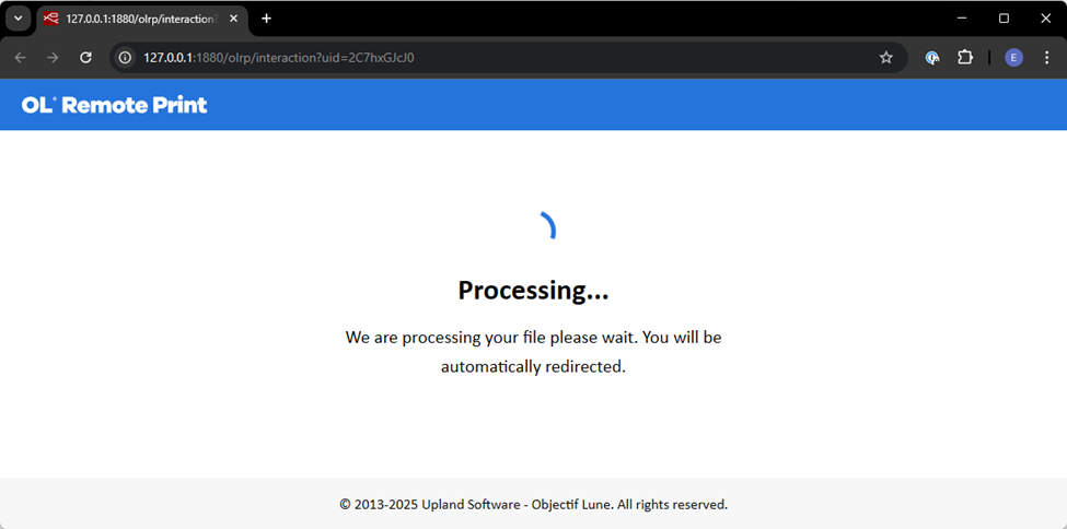

The result of this flow is a browser page showing the user a busy or processing screen when they submit a job.
A screenshot of OL Remote Print on a 'processing' browser page, at the URL specified.

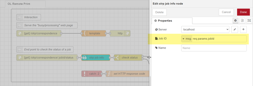

The value is assigned to the Job ID field of the olrp job info node, which uses it to retrieve the job’s metadata from the OLRP server.
Properties panel for the olrp job info node, with Job ID msg. req.params.jobID.

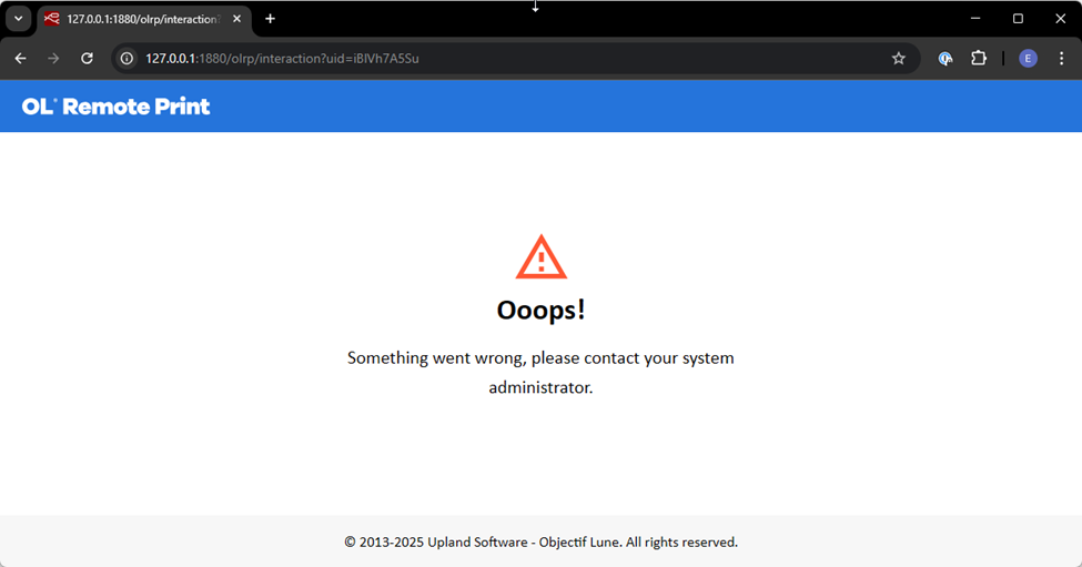

Error Trapping
If an error occurs, for example, if the job is not found on the OLRP server or if a request times out, the catch node is triggered. It captures the error and routes it to a function node, which defines the appropriate HTTP response code (such as 404 for Not Found or 500 for Server Error).
You can customize the behavior of the function node to suit your needs.
The response is sent back to the JavaScript code embedded in the web page, allowing the interface to display a user-friendly error message, as shown below. This provides basic feedback in cases of communication failure or job resolution issues.
A browser screen, with a red exclamation mark icon and the text "Oops, something went wrong, please contact your system administrator."
