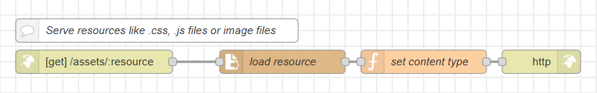

A four-node workflow to serve local files. Nodes are described in the text below.

Flow setup
Create the end point
Insert an http in node, configured to set the Method to GET and URL to:
Copy
/assets/:resource
This sets up a route where :resource is a path variable (e.g. styles.css). The requested filename will be available as msg.req.params.resource.
Load the file
Add a read file name and set the filename using a JSONata expression:
Copy
$env("ENV_PROJECT_A") & "\\assets\\" & msg.req.params.resource
This dynamically reads the requested file from the local assets folder.

In our scenario we will set this dynamically based on the file extension of the requested file. Add a function node after the file read to assign the correct Content-Type header based on the file extension.

Result
When you navigate to:
http://localhost:1880/assets/styles.css
OL Connect Automate:
  • Reads styles.css from the local assets folder (under ENV_PROJECT_A).
  • Serves it with the correct Content-Type header (text/css).
This makes your project more portable and avoids hardcoded file paths outside the flow logic.
