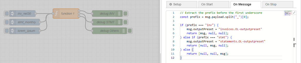

Dynamic routing and setting additional properties
In the following example, the function node not only routes the message but also sets msg.outputPreset, which can be used to dynamically select the output preset in a paginated output node.
Copy
// Extract the prefix before the first underscore
const prefix = msg.payload.split("_")[0];
if (prefix === "inv") {
    msg.outputPreset = "invoices.OL-outputpreset"
    return [msg, null, null];
} else if (prefix === "stmt") {
    msg.outputPreset = "statements.OL-outputpreset"
    return [null, msg, null];
} else {
    return [null, null, msg];
A flow with three input nodes, a switch node, and three debug (output) nodes, and the properties panel, On Message tab, showing the script.
