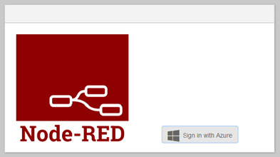

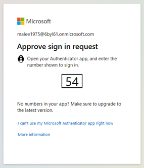

Log in
The following images illustrate the authentication flow, from login through to 2FA via Microsoft Online. After authentication with 2FA the user is redirected back to Node-RED. As with OAuth based systems, a user once validated does not need to revalidate their identity to login.
