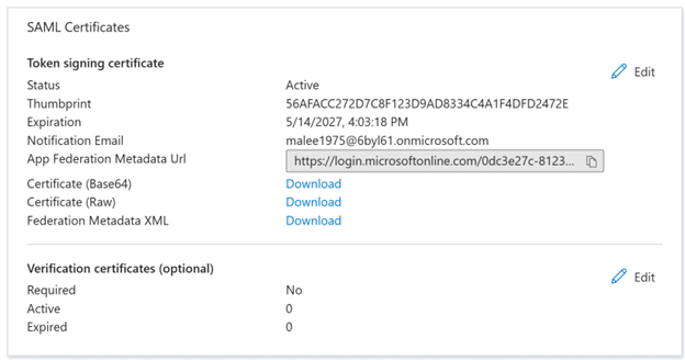

  4. Download the certificate from the SAML configuration page in the Azure portal. The required certificate is the base64 formatted one.
  5. Copy the certificates downloaded from the identity provider over to the same directory as the settings.js file.
