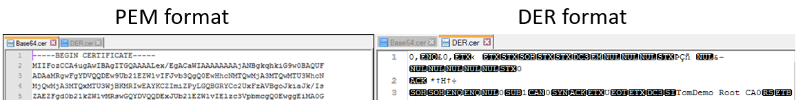

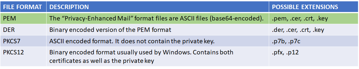

Once obtained, the format of the certificate file received may be either one of these four formats: PEM, DER, PKCS7 or PKCS12.
Only private key files in the PEM format (ASCII base64 encoded) can be used to set up secure communication in Workflow.
In a text editor, all characters in a PEM file are displayed as text, whereas some characters in a DER file will be displayed as symbols.
