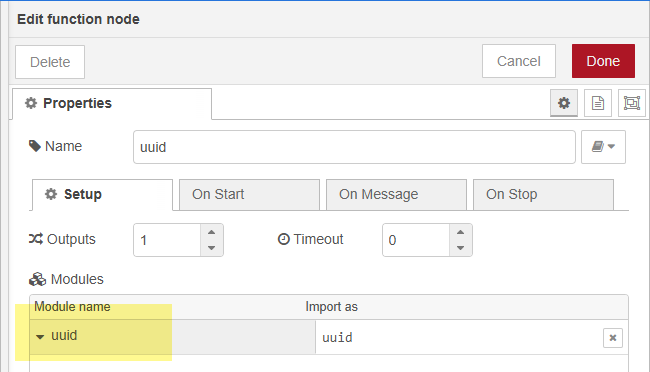

  1. Double-click a function node to go to its Properties.
  2. Enter a descriptive name for the node, such as uuid.
  3. Select the SetUp tab.
  4. Below the Modules section, click +Add.
  5. For module name, enter uuid. This is copied to Import as.
The properties panel of a function node, with Setup fields populated as described in the text above.

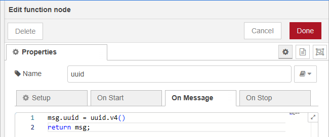

  1. Select the On Message tab.
  2. Enter the following for line one. Line two completes automatically.
    Copy
    msg.uuid = uuid.v4()
The properties panel of a function node, with On Message fields populated as described in the text above.
  1. When this node is deployed in a flow, the UUID is returned as a message payload. A sample result is:
    87d76f78-484e-4d3c-bc03-83beb2e7fcbf
