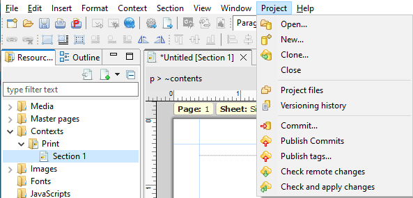

Creating versioned projects
Versioned projects are created from the Project menu at the top of the screen in OL Connect Designer and Datamapper.
You have two options:
  • Create a new versioned project that is only stored locally.
  • Clone a project that exists on a cloud-based platform into a local repository.
How to clone a project is explained in Versioned projects in the cloud.

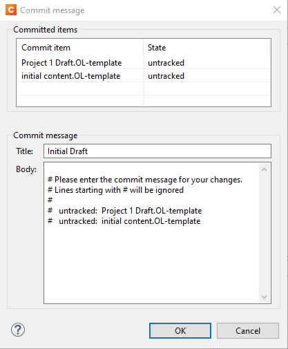

  4. To record this version in the repository, select Project > Commit. This records the project files as a new version in the repository. Remember to save any changes before you commit.
    To commit a single changed file, right-click the file in the Project files panel and select Commit.
    Note: The .gitignore file in the project folder tells Git which subfolders and files should not be committed.
  5. Enter information to describe the changes, then select OK. Describing the changes is important as it will allow you, later, to readily identify each version as you browse through the project history.

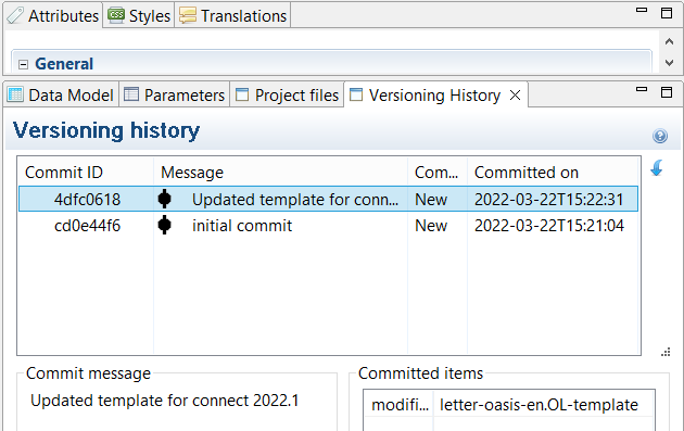

Viewing project history
The project history contains the records for all of the changes made to each resource in the project. When you commit a project, a snapshot of the project resources is stored as a version. You can review the versions to see what changes were made, who made them, and when they were made.
To see the history of the project:
  1. With the project open in Designer, select Project > Versioning history from the menu bar.
  2. The history displays in the Versioning History tab.
You can select a version from the list to display more information about the changes made in that version.

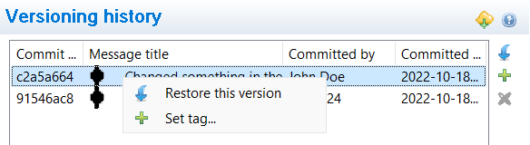

Restoring a version
To restore a previous version, select the version, then select the Restore icon. The project is reset to the state it was in when that version was committed.

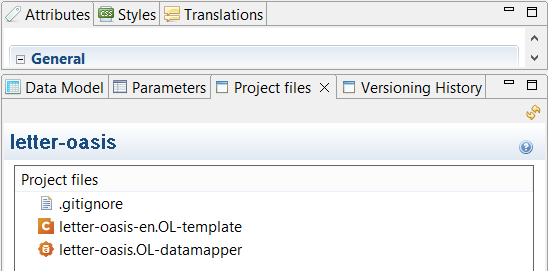

Viewing project content

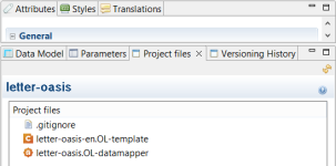

Select the Project files option from the Project menu to display the list of resources in the project.
The files comprising a project display in the Project files panel.
Double-click a file to open it.
Right-click a file to open the contextual menu. From there you can not only open, commit or revert it, but also select to view its properties or to open the folder in which the file is located in Windows' File Explorer.

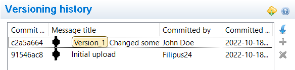

Using tags
The Tag functionality allows any commit to be identified with a user-defined label. Think of it as setting a flag on your versioning history whenever you want to highlight that, at that specific stage, something is more remarkable than on other commits. For instance, you can mark the latest commit with a tag named Version_1, thereby indicating that this is the first version of the entire project that goes into production.
To do that, simply right-click on one of the commits in the Version History and select Set Tag, then enter a tag name.
Note: Tag names must be unique. A different capitalization does not make a name unique. Spaces are not allowed.
The Versioning history panel displays any tags immediately before the message title:
You can add as many tags as you like, and you can delete them (right-click the tag, then click Delete) and re-use them on a different commit (which is the equivalent of moving a tag).
