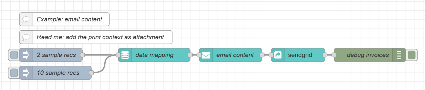

Add the Print context as attachment
This flow generates personalized email messages for XML data using the email content node and sends the result via the SendGrid service.
The data mapping node extracts data from a data file and stores the data in the OL Connect database.
The email content node merges this data with a template, returning an array with information about the generated messages in msg.payload.
This data is processed by the sendgrid node which sends the email messages using the SendGrid API.
Use the inject nodes to trigger the process with a data set of 2 records or 10 records.

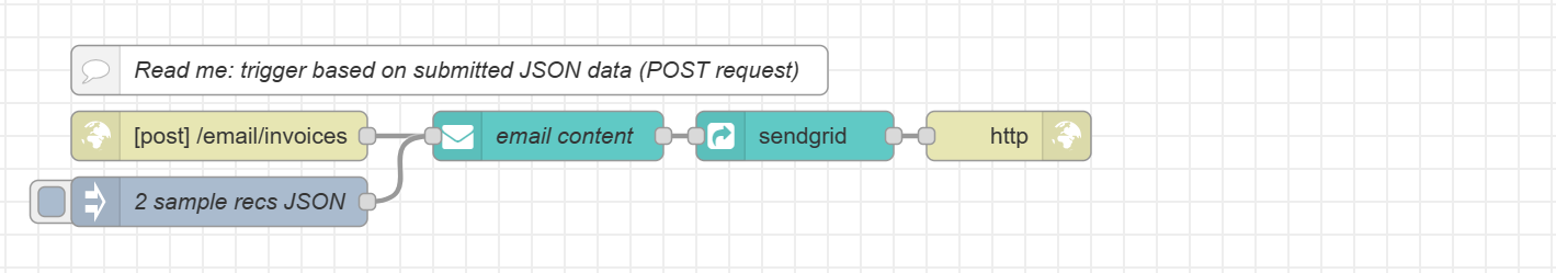

Trigger based on submitted JSON data (POST request)
For this example the http in node is set up to listen to POST requests.
Use the tool Postman.app to submit sample data this process.
  1. Add a request using the POST method. Sample URL: http://localhost:1880/email/invoices
  2. Click Body and choose raw.
  3. Add the JSON data below to the text area and before posting, set the format of the raw data to JSON.
