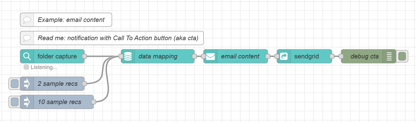

The notification with call to action (cta) flow
The data mapping node extracts data from a data file and stores the data in the OL Connect database.
The email content node merges this data with a template, returning an array with information about the generated messages in msg.payload.
This data is processed by the sendgrid node which sends the email messages using the SendGrid API.
Use the inject nodes to trigger the process with a data set of 2 records or 10 records.
Alternatively, trigger the process using the Folder capture node, by copying one of the resource files (email-cta-2.xml or email-cta-10.xml) into the \workspace\email\cta\in directory.
