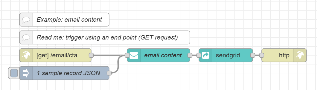

Trigger using an end point (GET request)
This sample email flow generates personalized email messages using the email content node based on data provided via the http in node.
For an http in node that uses the `GET` method Node-RED automatically captures URL parameters and stores them in msg.payload.
The email content node passes objects stored in msg.payload to the Data Model of the template, allowing the template to use this data for personalization purposes (in scripts or expressions).
Sample URL for the end point using the GET method: [http://localhost:1880/email/cta?first=Emmerich&email=eballinger0@olacme.com
Use the inject nodes to trigger the process with a data set of 1 record. These pass JSON data via msg.payload.

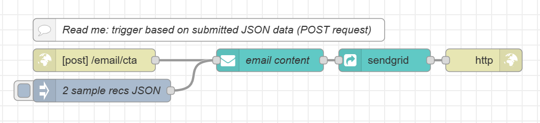

Trigger by submitting JSON data (POST request)
In this example the http in node is set up to listen to POST requests.
Use the tool Postman.app to submit sample data this process.
  1. Add a request using the POST method. Sample URL: http://localhost:1880/email/cta
  2. Click Body and choose raw.
  3. Add the JSON data below to the text area and before posting, set the format of the raw data to JSON.
    Copy
    "first": "Emmerich",
    "last": "Ballinger",
    "email": "eballinger0@olacme.com",
    "guid": "6faffd34-6a9a-4aa3-abdc-4a86da569713"
    "first": "Jody",
    "last": "Ekell",
    "email": "jekell1@olacme.com",
    "guid": "706bb59a-804c-469c-9f77-a19896adceb6"
