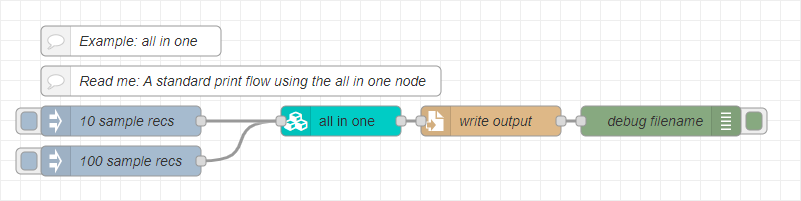

The sample flow
In its simplest form, a print flow may consist of a node that captures a data file, such as a folder capture node or read file node, the all in one node, and a node to save the result to disk.
For this example the flow is triggered using one of two inject nodes, each providing a hard-coded path to a data file in msg.filename. Use the inject nodes to trigger the process with a data set of 10 records or 100 records.
Tip: Adding multiple inject nodes to your flow is a great way to test the flow with data files of different sizes.
The flow uses the write file node to store the print output file to disk. The print output file, a zip archive containing all documents, is written to workspace\all in one\output.zip.
