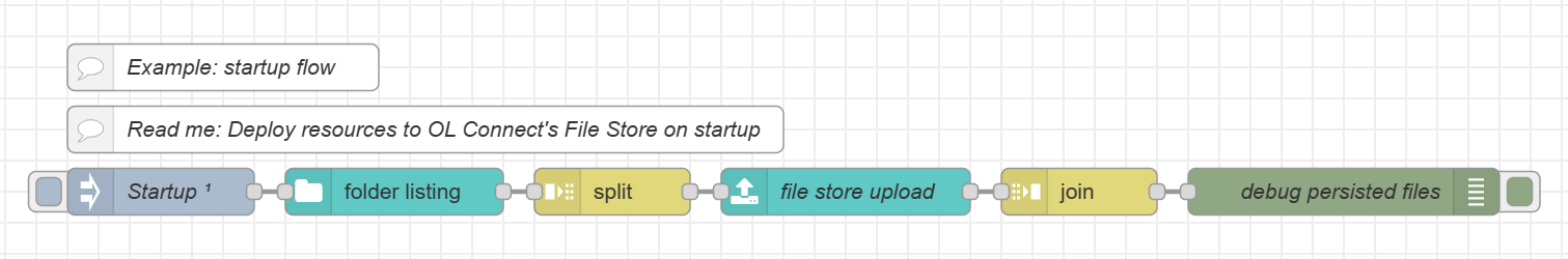

The inject node is configured to trigger this flow once, on deploying the flow.
The folder listing node returns an array with file paths in msg.payload.
The split node iterates over the entries in this array.
Subsequently, the file store upload node uploads the file to the OL Connect Server.
