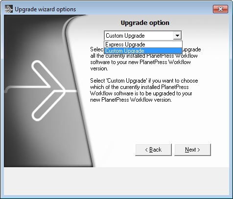

  8. Then select your upgrade type:

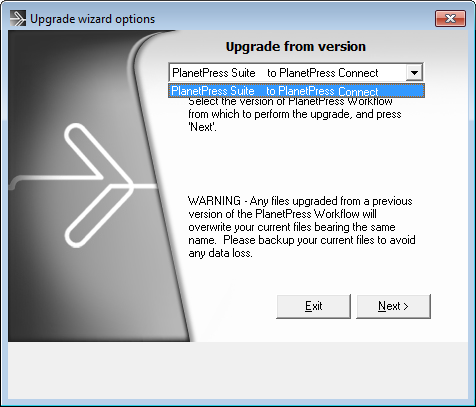

  9. Then select the product from which you wish to upgrade:
  10. If you selected to do a Custom upgrade, select the required options:

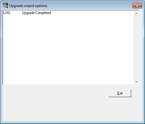

  11. Then finally review the log in the final dialog for details on how it went:
