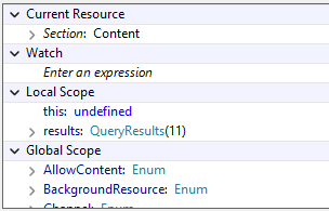

Variables
At the bottom right the Script Debugger shows a hierarchical overview of all variables in the scope chain and their state.
If the current script is not a Control Script, the overview includes the special entry "Current Resource". When expanded, this entry shows the HTML of the current Master Page or section, allowing you to see exactly how each line in the script affects the DOM.
The Local Scope overview includes the special entry "this", which represents the JavaScript "this" object.
Press Ctrl+C to copy the label and contents of the selected variable and all of its children to the clipboard.
Expressions
You can add custom expressions. This is especially useful when you want to monitor the value of a variable that is situated at a lower level in the hierarchy. For example, if you'd want to directly see the height of the top margin of a section as you step through the code, you could add the following expression: merge.section.margins.top.
Expressions can include function calls. For example, you could monitor the height of an element that has the ID my_div with the expression: query("#my_div").height(). Note that the query in this example will be limited to the current resource (Master Page or section).
You could also change the value of a variable through an expression to see how that affects the document. Let's suppose execution is suspended before an if-statement: if (foo == 3). If foo is not equal to 3, but you'd still like to see what would happen if it were, you could add the expression foo = 3.
Expressions are evaluated automatically when execution is suspended.
  • You can enter an expression in the field below Watch. Expressions must be unique and cannot be empty; empty expressions will be removed.
  • To edit an existing expression, double-click the entry.
  • You can delete a watch expression by making it empty or by pressing Del.
