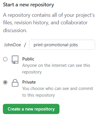

  1. Log on to your Git repository hosting service and create a new project that will host the files for a new project. In BitBucket, for example, it looks like this:
  2. Once the new repository has been created, you are presented with the URL of the new project. Copy the URL; you will need it in a following step.

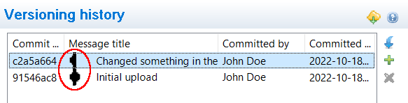

Whenever you publish commits to, or pull changes from the online repository, the versioning history panel (Project > Versioning history) is updated to reflect whether the local and remote versions are in sync.
A full circle before the message means the local and remote versions of that commit are in sync.
Half a circle on the left hand side of the axis indicates the commit was made locally but has yet to be published to the online repository.
If someone were to make changes to the online version that the local version doesn’t have yet, then that half circle would be on the right hand side of the axis.
