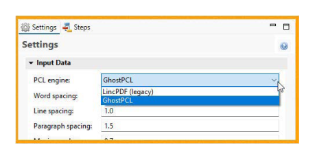

Updated PCL input options - GhostPCL
A new PCL input option has been added to the DataMapper. You will now be able to chose between the new GhostPCL or the older LincPDF libraries to import PCL files. This enhancement addresses known limitations in the existing PCL processing capabilities, such as problems with large files and issues with rendering inconsistencies.
The ability to swap between these libraries means you have more options to cope with the limitations of either library. (97029)

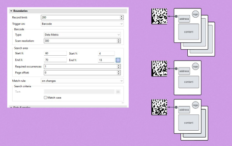

Defining document boundaries based of barcodes
This release introduces support for barcode-based document boundary detection in the DataMapper. (97117)
With this capability, the DataMapper can now detect document boundaries directly from barcodes embedded in print-ready input files, such as PDF and PostScript. Users can define specific regions, similar to text-based boundary detection, and configure match rules to determine when a new document begins.
By handling barcode detection natively within the DataMapper, this feature eliminates the need for external barcode scanning steps in Workflow or Automate. This enhancement thus streamlines automation scenarios, simplifying overall solution architecture, and reducing reliance on custom or intermediary processing components.

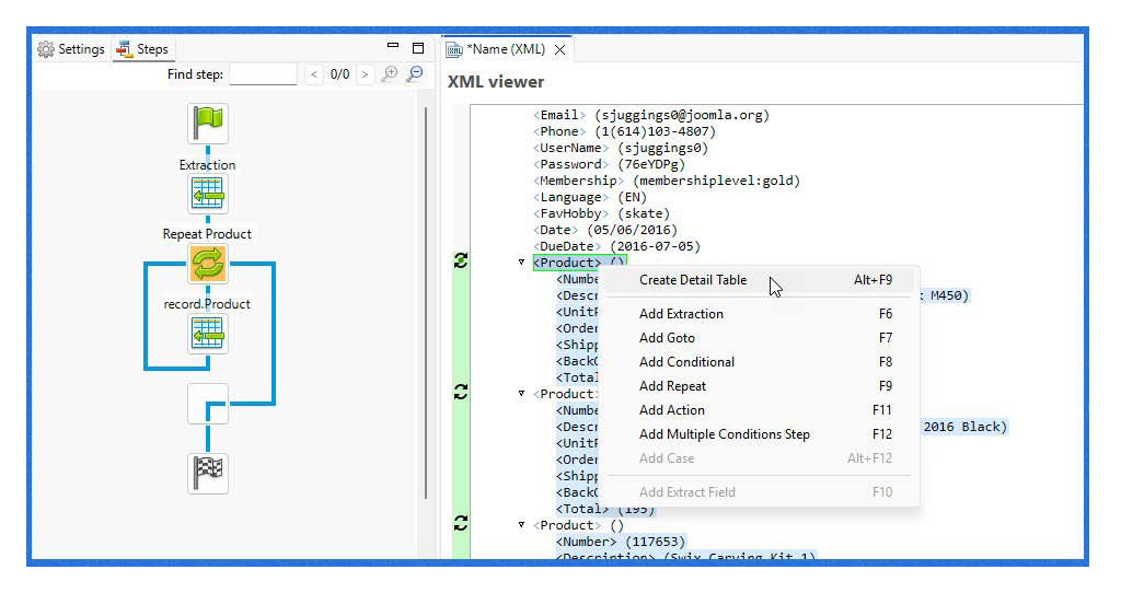

Automatic Array to Detail Table conversion for XML data
This release extends the “Create Detail Tables” functionality to XML-based data models. (97038)
With this enhancement, you can select a node that is part of a repeating structure in an XML document and automatically generate a corresponding detail table in a single step. Previously, this required multiple manual actions, including defining repeats and creating individual extractions.
This provides a more efficient and intuitive starting point for building detail tables and working with line-item data.

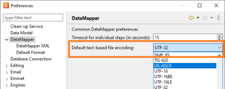

  • Added a setting for selecting the default encoding to be used for DataMapper text file configurations. (96795)
