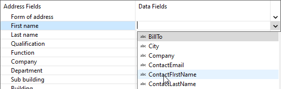

The fields in the Address Fields column are organized roughly in the same way they will appear in the address block.
To connect a data field to an address field, click the Data Fields column, then select the field that provides the data for that address field.
Tip: To shorten the list, start typing (part of) the name of the data field you are looking for.
The example of the address block at the bottom left will be populated with data from the current record in the currently open dataset.
To remove the connection between a data field and an address field, click the field in the Data Fields column, then press the Delete or Backspace key and navigate out of the field.
