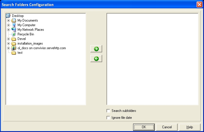

- Choose Options | Set Search Folders and use the Search Folders Configuration dialog box that appears to select the OL ConnectImage archive folders to include in the database.
Note: In a network installation, you should verify that each folder you include is accessible to all users of this search profile. If a folder is not accessible, users cannot view any search result that references a PDF in that folder.
A. Navigator pane B. Archive folders list C. Add arrow D. Remove arrow
Navigate TO A FOLDER
Navigator pane: Use to navigate to each folder you want to include in the database.
add OR REMOVE archive folders.
Add arrow: Use to add a folder to the Archive folders list. Click the folder you want to add then click the Add arrow. You can also add a folder by clicking a folder in the Navigator pane and dragging it to the Archive folders list.
Remove arrow: Use to remove a folder from the Archive folders list. Click the folder you want to remove then click the Remove arrow. You can also remove a folder by double-clicking it in the Archive folders list.
SPECIFY HOW TO HANDLE SUBFOLDERS
Search subfolders: Select to recursively include all subfolders OL Connect Search finds in the folder, in the database. Clear to have OL Connect Search exclude any subfolders it finds in the folder, from the database.
Ignore file date: Select to have OL Connect Search read the contents of all PDI files in the folder, regardless of their creation date, when it refreshes the database. Clear to have OL Connect Searchread only those PDI files whose creation date is more recent than the date of the last refresh of this database. You use this option to reduce the time required to refresh the database, particularly when only a few PDI files have changed since the last refresh.
- Once you have selected all the folders to include in the database, in the Search Folders Configuration dialog box, click OK.

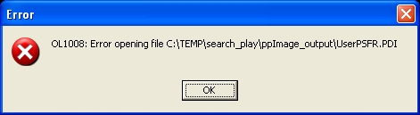

OL Connect Search examines the archive folders you specified and for each document it finds, creates a record in the database. If you cleared the Unattended database creation/update option in the Database options of User Options, OL Connect Search displays a message if it encounters an error. Click OK to continue.

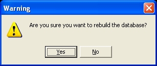

- In OL Connect Search, choose Options | RebuildDatabase.
OL Connect Search prompts you to confirm the build.
- Click Yes to confirm.

If you cleared the Unattended database creation/update option in the Database options of User Options, OL Connect Search prompts you for confirmation to continue if it encounters an error.
