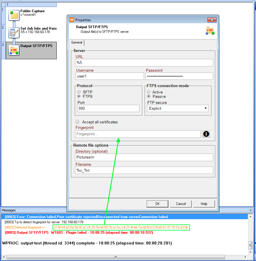

How to get the server's fingerprint
To get the server's fingerprint, run the plugin once in debug mode with an empty fingerprint value. The server's fingerprint will be written to the message log, from which you can copy it to the plugin's field.

- Accept all certificates: Check this option to automatically accept the certificates returned by the FTP server. Otherwise, in order for a connection to work, the server's fingerprint is needed.
- Fingerprint: The RSA fingerprint of the server. The current job file is only uploaded to the remote server if the fingerprint corresponds to the server's certificate. See How to get the server's fingerprint.
