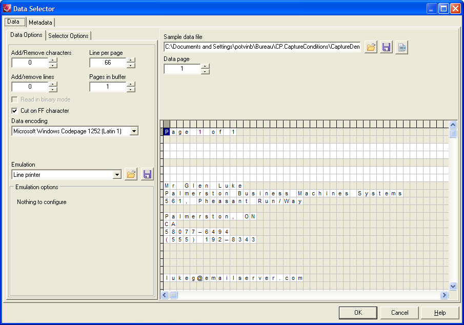

Data tab
The Data tab contains the Data Options, which let you select your emulation, and the Selector Options, which let you personalize the data selector's display options (see Data Selector display preferences).
The Data Selector uses the emulation (either the emulation chosen when the sample data file was selected, or the one chosen in the last Change Emulation action task appearing above the current task) to format the data. It displays the formatted data to let you make selections easily using the mouse pointer.
Depending on the chosen emulation and data file, the options in the Data Selector, the Sample data file section and the Data pane itself may change to accommodate your choice. The Line Printer, Ascii, Channel Skip and User-Defined emulations will display the default options (see About data emulation) and a grid-like display of each character on each line. The following emulations however, will be slightly different.
