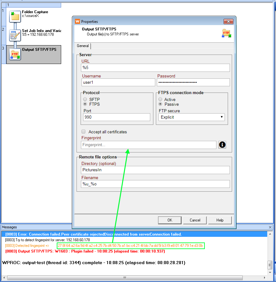

Note that if the plugin is not set to automatically accept the certificate returned by the FTP server, it only uploads files to the server if the server's RSA fingerprint defined in the task's properties corresponds to the server's certificate.
How to get the server's fingerprint
To get the server's fingerprint, run the plugin once in debug mode with an empty fingerprint value. The server's fingerprint will be written to the message log, from which you can copy it to the plugin's field.

Partial transfers are enabled by default. - Accept all certificates: Check this option to automatically accept the certificates returned by the FTP server. Otherwise, in order for a connection to work, the server's fingerprint is needed.
 - Fingerprint: The RSA fingerprint of the server. The current job file is only uploaded to the remote server if the fingerprint corresponds to the server's certificate. See How to get the server's fingerprint.
