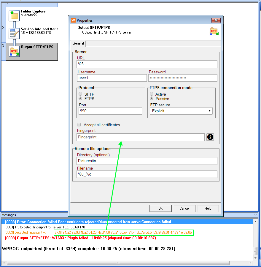

Note that if the plugin is not set to automatically accept the certificate returned by the FTP server, it only downloads files from the server if the server's RSA fingerprint defined in the task's properties corresponds to the server's certificate.
How to get the server's fingerprint
To get the server's fingerprint, run the plugin once in debug mode with an empty fingerprint value. The server's fingerprint will be written to the message log, from which you can copy it to the plugin's field.
