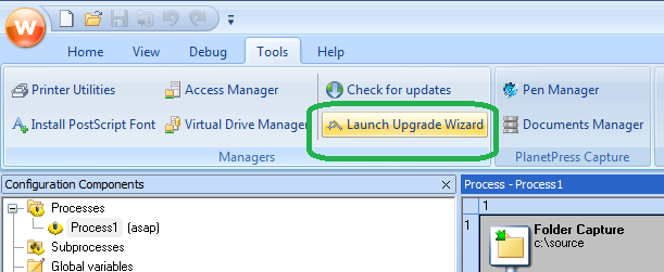

  7. To launch the Upgrade wizard, open the OL Connect Workflow 8 configuration tool and, from the Tools menu, launch the Upgrade Wizard.

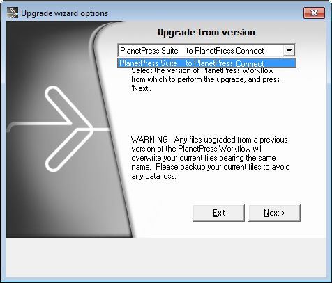

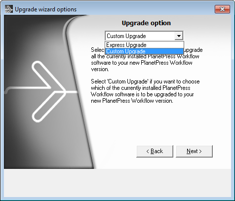

  8. Then select your upgrade type:
  9. Then select the product from which you wish to upgrade:

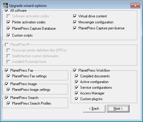

  10. If you selected to do a Custom upgrade, select the required options:

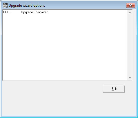

  11. Then finally review the log in the final dialog for details on how it went:
