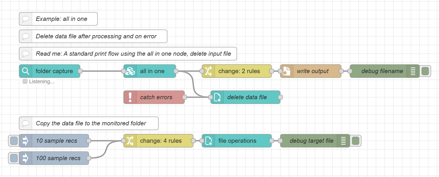

A print flow that deletes the input file
This example flow illustrates a technique to delete the input file.
The flow consists of two parts. The inject flow copies sample data to the monitored folder of the main flow. This prevents sample data from being deleted.
Subsequently the file operations node is used to delete the data file on success and on error. Possible errors are trapped with a catch node. This branch could also be used to notify the admin, for example by sending an email.
