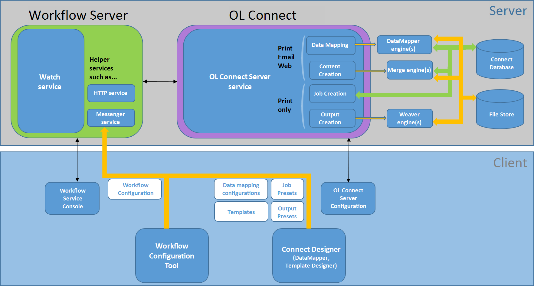

Here's a simplified, graphical representation of the architecture of OL Connect.

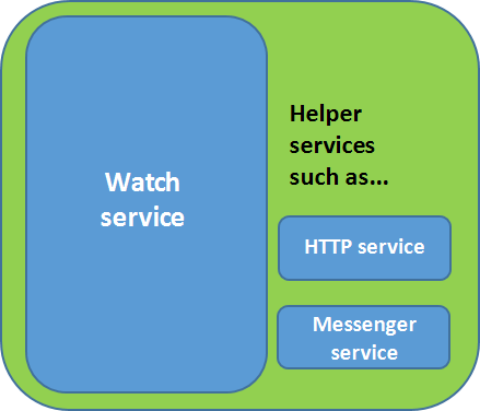

The Workflow server
The Workflow server (also referred to as the 'Watch service') executes processes independently, after a Workflow configuration has been uploaded and the services have been started. The Workflow server can run only one configuration at a time.
There are a number of services related to Workflow. The OL Connect Messenger service, for example, receives the files sent to Workflow from the Designer and the Workflow configuration tool.
The Workflow Service Console lets you start and stop the different services, except the Connect server, and see their log files (see Workflow Service Console).
Note that Workflow isn't limited to Connect functionality. It was originally developed as part of the PlanetPress Suite. Many of the plugins in the Workflow configuration tool are older than Connect. They were left in for compatibility reasons, even though they aren't all useful or usable within Connect. However, the Connect plugins cannot be used with the PlanetPress Suite software.

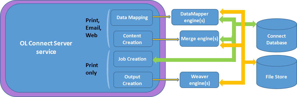

The OL Connect server
As opposed to the Workflow server, the Connect server was designed to be used only with Connect. The OL Connect server performs several different tasks, all of which are related to Connect content and content management:
It communicates with the Workflow service (with the OL Connect plugins, specifically) and with the Designer when output is generated from the Designer. It creates records (by extracting data from a data source using a data mapping configuration), and jobs. It communicates with the engines (see below) in order to make them create content items and output (spool) files.
The OL Connect server is one of the components that has to be installed with Connect (see Installation Wizard).
In the Workflow Configuration Tool preferences you have to set the OL Connect server settings to enable Workflow to communicate with the server (see Workflow Preferences).
The OL Connect Server Configuration tool lets you change the settings for the Connect server, the engines and the service that cleans up the database and the file store. These settings can also be made in the preferences of the Designer.
The OL Connect database
The OL Connect database is the database back-end used by OL Connect itself when processing jobs. It can be either the MariaDB instance provided by the OL Connect installer, or a pre-existing (external) instance (see Database Considerations).
All generated items (records, content items etc.) are stored in this database.
Note: Email content items are not stored in the OL Connect database.
A clean-up of the database is performed at regular intervals in accordance with the settings (see Clean-up Service preferences).
The File Store
OL Connect has its own File Store which it uses for transient files.
The Clean-up service takes care of removing obsolete files when those files are not marked as permanent (see Clean-up Service preferences).
Tip: The File Store is accessible for customer implementations. The Workflow configuration tool implements three tasks that allow you to Upload, Download and Delete files in the OL Connect File Store. The files can be accessed through the REST API, which means web portals could potentially access the files directly without having to go through a Workflow process (see The Connect API).
The engines
DataMapper engines. A DataMapper engine extracts data from a data file. The number of DataMapper engines is configurable (Engines preferences).
Merge engine/s. A Merge engine merges data with a template using the scripts in the template, in order to create content items.
The number of merge engines is configurable (see Engines preferences): it can be increased depending on the capacity of the machine that runs the solution (see Performance considerations).
Weaver engines. A Weaver engine creates Print output from Print content items. It takes the settings made in Print Presets or in the Print Wizard into account.
The number of Weaver engines is configurable as well (see Engines preferences).
Note: The Proof Print function doesn't print via the OL Connect Server; it uses the Designer's internal engines.
The REST API

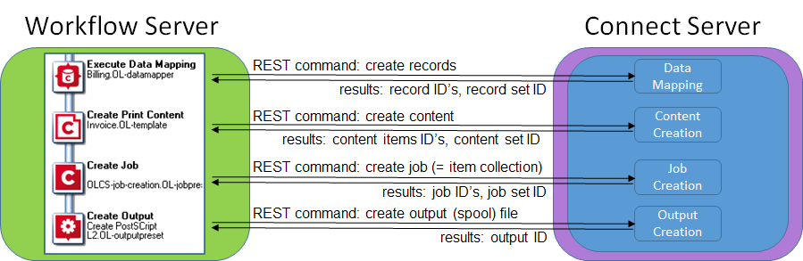

The OL Connect server receives REST commands (see The Connect API), normally either via the Workflow service or from the Designer. This design allows the OL Connect functionality to be used by other applications. The server forwards the commands to the appropriate engine and returns the results to the caller. The results are the id's of the items (records, content items, job etc.) that are stored in the OL Connect database (see below). All OL Connect tasks except the Create Web Content task integrate the results in the Metadata in Workflow.
The figure below shows the communication between OL Connect tasks and the OL Connect server in a Print process.
