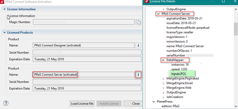

To be able to import PCL input files, you will need the PCL Input license, in addition to OL Connect.
To check if you have a PCL Input license:
Open the Connect Software Activation module.
Click on the "i" icon next to the OL Connect Server product.
When the License File Details window opens, expand the OL Connect Server, then expand the DataMapper node. If the Inputs.PCL entry is present in that node, you have a PCL Input license.

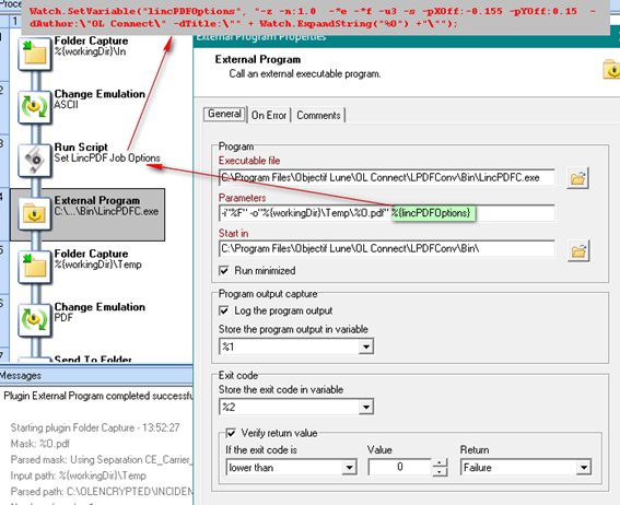

As the number of options you pass to LincPDFC may be high, it is recommended to assign all the desired options to the local variable lincPDFOptions. To do that you can use either the Set Job Infos and Variables plugin or a Run Script Action plugin, for example with the following JavaScript:
CopyWatch.SetVariable("lincPDFOptions","-z:1 -*e -*f -u3 -s -pXOff:-0.155 -pYOff:0.15 -dAuthor:\"OL Connect\" -dTitle:\"" + Watch.ExpandString("%O") + "\"");This example sets the following options or parameters:

Next, use the External Program plugin to convert the PCL to PDF with the above %{lincPDFOptions} options.
In the General tab:
Set the Executable file to: C:\Program Files\Objectif Lune\OL Connect\LPDFConv\Bin\LincPDFC.exe
Set the Parameters to: -i"%F" -o"%{workingDir}\Temp\%O.pdf" %{lincPDFOptions}
As a minimum, LincPDFC requires an input file, which is set here via the parameter –i to which we are assigning the current job file path and name “%F”, and an output file path and name set here using the –o parameter with a dynamic value of "%{workingDir}\Temp\%O.pdf".
Select the "Run minimized" option to run the program in the background
You may select to Log the program output for additional troubleshooting. This is optional; however when activated LincPDFC detailed conversion will be added to the Workflow log.
Save the output of LincPDFC using the –o folder specifier in the parameter (%{workingDir}\Temp, in this case.)

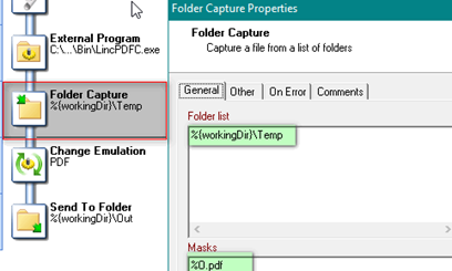

In another Workflow process, import the created PDF with the Folder Capture input plugin, specifying the output folder of the previous process (%{workingDir}\Temp in the example) as input folder, and %O.pdf as the file mask.
Once you have the PDF as job file, you may pass it to the Execute Data Mapping plugin for further processing.

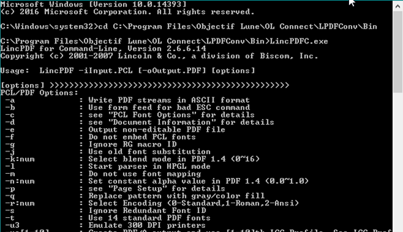

To view the available options that can be set in LincPDF, run the executable (LincPDFC.exe) in a command prompt window. It will display a help message with available options.
/*Open Windows Command Prompt
			Change directory
			cd C:\Program Files\Objectif Lune\OL Connect\LPDFConv\Bin
			LincPDF for Command-Line, Version 2.6.6.14
			Copyright (c) 2001-2007 Lincoln & Co., a division of Biscom, Inc.
			Usage:  LincPDF -iInput.PCL [-oOutput.PDF] [options]
