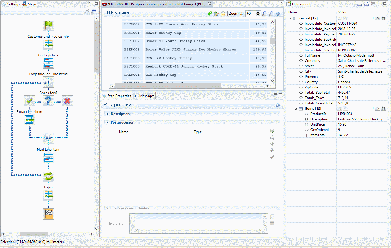

  • Select the Postprocessor step on the Steps pane.
  • On the Step properties pane, under Postprocessor, click the Add button.
  • Under Postprocessor definition, add the script. Postprocessor tasks must be written in JavaScript (see Using scripts in the DataMapper and DataMapper Scripts API).

Configuring the Postprocessor step
For an explanation of the settings for post-processors, see Postprocessor step properties.
