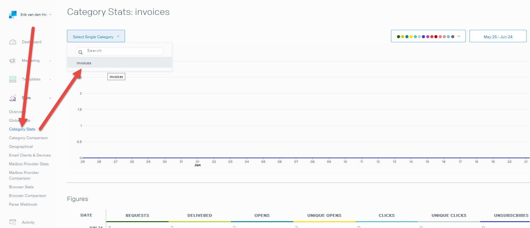

SendGrid
Dashboard: https://app.sendgrid.com/
Documentation: https://sendgrid.com/docs/API_Reference/SMTP_API/using_the_smtp_api.html.
Write a Control Script that adds a header with the name X-SMTPAPI and sets its content to the required JSON string (for example: "' category': ['invoices']").
For example:
var headerObj = {
    "category": ["invoices"]
merge.context.sections["Content"].addHeader("X-SMTPAPI", JSON.stringify(headerObj));
                                                    If the email is going to be sent by the OL Connect SendGrid plugin, the X-SMTPAPI header will not be used. Enter the category or categories in the plugin's settings instead.
Note: Sendgrid strips out their own mail headers. The results need to be verified via their Dashboards (e.g. the Stats section lets you verify the stats for specific categories). Alternatively one can use their Web API to retrieve stats in JSON format. To view the category stats, log in to Sendgrid and choose: Stats > Category Stats > your category name.

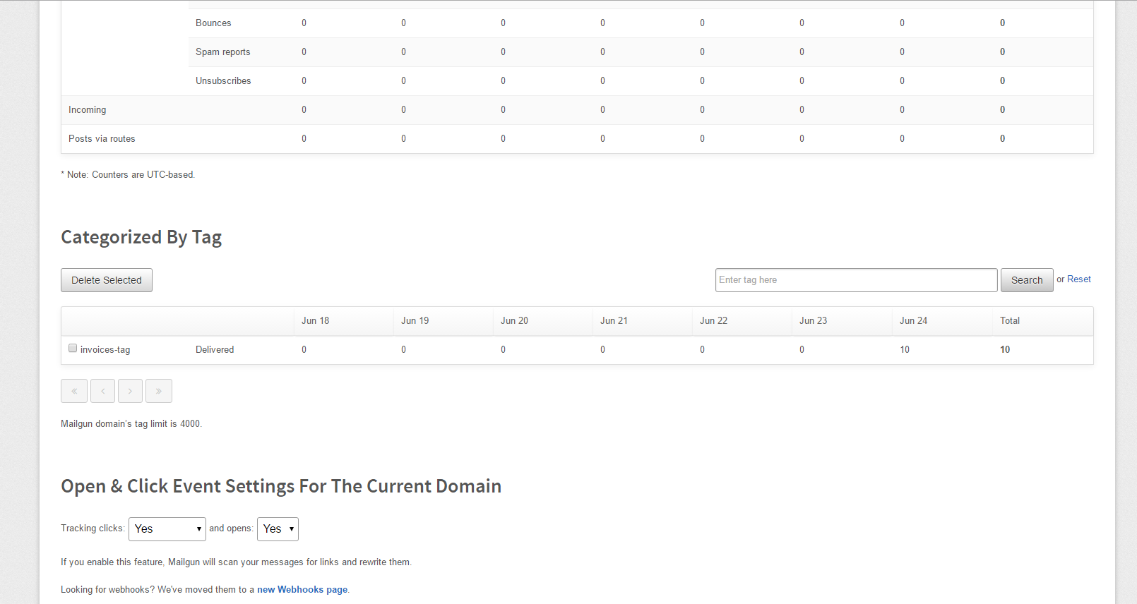

MailGun
Dashboard: https://mailgun.com/cp/stats
Documentation: https://documentation.mailgun.com/api-sending.html#sending
Write a Control Script that adds a header with the name X-Mailgun-Tag and sets its content (for example: invoices).
For example:
merge.context.sections["Content"].addHeader("X-Mailgun-Tag", "invoices");
                                                    You may specify multiple categories, as follows:
var headerObj = {
"category": [
"dogs",
"animals",
"pets",
"mammals"
var section = merge.context.sections["Content"];
section.addHeader("X-Mailgun-Tag", JSON.stringify(headerObj));
                                                    Note: The Mailgun tag allows you to view the stats per tag. Mailgun has a quick refresh and stats are available almost instantly.

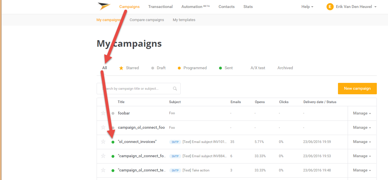

MailJet
Dashboard: https://app.mailjet.com/dashboard
Documentation: https://app.mailjet.com/docs/emails_headers
Write a Control Script that adds a header  with the name X-Mailjet-Campaign and sets its content to the name of the campaign (for example: invoices).
For example:
merge.context.sections["Content"].addHeader("X-Mailjet-Campaign", "invoices");
                                                    If the email is going to be sent by the OL Connect Mailjet plugin, the X-Mailjet-Campaign header will not be used. Enter the campaign in the plugin's settings instead.
Note: Mailjet strips out their own mailheaders like X-Mailjet-Campaign. The results can only be verified via the respective campaign stats page in the Mailjet dashboard. There is no need to pre-create the campaign: adding it to the email header via a Control Script auto-generates the campaign. To view the campaign, login to Mailjet and choose: Campaigns > All.
