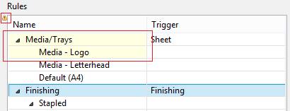

If a Media/Trays Rule has an associated Printer Option that matches a Media entry in the Template or Presets, then it is highlighted in light green.
It is possible to create a set of Rules in which none of the Rules ever evaluate to true, and thus no Rule will be applied. This could be done on purpose, to allow the printer's default settings to apply.

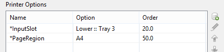

We can see that one has an Order Dependency of 50 and the other 20.

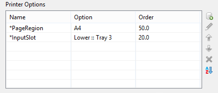

If PageRegion was selected prior to InputSlot in the Add Printer Option dialog, then they would appear like this in the Print Wizard:
To sort them into the correct dependance order, use the Sort by Order dependency button. This will sort them into the proper dependency sequence. As seen below, where the lower dependency now appears first.

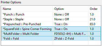

Caution: Nothing prevents the selection of conflicting and contradictory Print Options.
This can be seen in the following example, which shows multiple conflicting Folding Options have been chosen:
The breadth and diversity of PPD files as well as individual printer capabilities mean that the Print Wizard cannot meaningfully validate the selections made, and thus does not attempt to.
So you must be careful when making selections. We recommend that you always test each individual selection made, to confirm that they are valid and that they do what you expected of them.
This could entail considerable trial and error, but should lead to less anguish in the long run.
