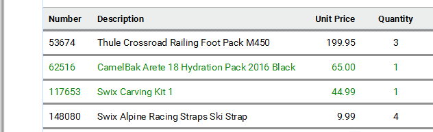

Example: Styling a row based on a value in a detail table
Here are two scripts that have the same effect: if in a row, the value of the field Shipped is 1, it colors the text of that row green.
The first script targets a cell in a Dynamic Table row that has a [data-script='Shipped'] attribute. The script has its scope set to "Each matched element", so it can use this (see this) to access the selected cell and this.record to access the current detail record, without performing any loops.
Selector: table [data-script='Shipped'].
Scope: Each matched element
var field = this.record.fields['Shipped'];
if (field == 1)
    this.parent().css('color', 'green');
                                                    The following script targets the table, and has its scope set to "Result set". This script loops over the detail table in the record, evaluating the field Shipped. If the value of that field is 1, it looks up the corresponding row in the results (the selected Dynamic Table).
Selector: #table_1 tbody
Scope: Result set
for(var i = 0; i < record.tables.detail.length; i++){
    if(record.tables.detail[i].fields['Shipped'] == 1)
    query("tr:nth-child(" + (i+1) + ")", results).css('color','green');
