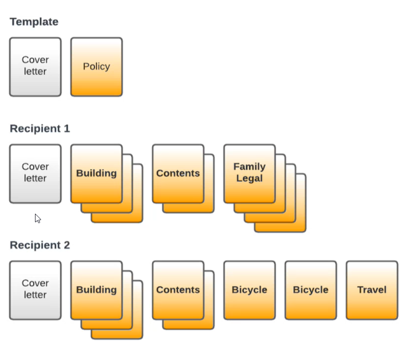

In the case of insurance policies, for example, a template would only need to contain a cover letter section and a policy section. For each recipient, the policy section would be cloned as many times as necessary, i.e. once for each insurance the recipient has.

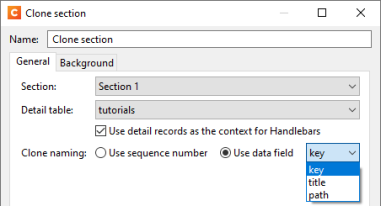

The wizard appears.
On the General tab, change the name of the script so that it reflects what the script does.
Note: Scripts can only have the same name when they are not in the same folder.
Select the section that must be cloned.
Select a detail table. As many clones are created for each recipient as there are records in that detail table.
Normally, Handlebars expressions in sections and clones retrieve data from the current main record. To make Handlebars expressions work on the detail record that was used to create the clone, rather than on the main record, select Use detail records as the context for Handlebars. The benefit of this is explained in Handlebars expressions in section clones.
Note that with this option selected, Handlebars expressions can still access the main record and any detail tables indirectly (via @root, see Handlebars expressions in section clones).
Chose the Clone name in the Clone naming section. Selection is between Use Sequence number, or Use data field, which allows selection of a field from the database.
Note: When a Template is saved to a version pre 2025.1, the Clone name will default to Sequence Number.

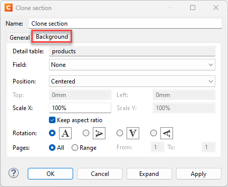

(Optional:) Switch to the Background tab if you want to apply PDF background images to the clones. See Setting a background image for section clones.

Note: The wizard expects the path to a background PDF to be specified in the detail table record on which the clone is based. If the path to a PDF is not specified in the data, follow the steps below, but select a random field in step 3. Then expand the script to construct the path in code. An example is given in the topic Clone Section scripts.
Open the Section Clone wizard; see Cloning a section using the wizard.
If you've already added the Section Clone script with the wizard, reopen the wizard by double-clicking the script. Or, right-click the section and select Section Cloning....
Switch to the Background tab.
Select the field that holds the path to a PDF. What the path should look like depends on the location of the image; see Resources.
Select the desired position, scaling, rotation and page range. For an explanation of these options, see Settings for a background image.
Click OK.
Or, click Expand if you need to change the script, for example if the path to the PDF needs to be constructed in the code (see Assigning a background PDF to a section clone).
