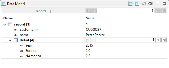

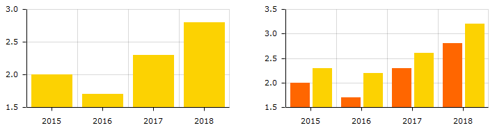

By default, a chart that is based on a detail table shows one series ("category") of bars/points per record. Each of the bars or points in a series has its own color and label, and represents one data field in that record.
The following image shows a detail table. Both of the Bar charts below are based on that detail table. The difference between the Bar charts is caused by the number of selected data fields (one, or two). The values of the data field 'Year' are used as Category (on the x-axis).
When creating a data mapping configuration (see Data mapping workflow), it is recommended to arrange data in a detail table in such a way that it matches this 'one series per record, one bar/point per data field' approach.
Occasionally you may find that data in a detail table does not match this approach, and that it would be a better fit if the chart had one series of bars/points for each selected detail data field instead, and one bar/point for each record.
If the number of records in a detail table is consistent throughout all records, it is recommended to modify the detail table in the data mapping configuration in order to make it match the default approach.
Otherwise this requires changing the Chart script: open the Chart script, click the Expand button, and alter the code that puts data in the dataProvider property.
