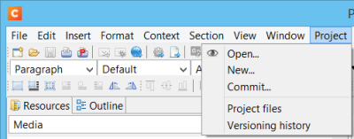

Note: Versioned projects are created from the Project menu at the top of the Welcome (or Home) screen. Projects created with the Sample Projects wizard are not versioned.
As you work on your project files, you can commit the files in the project at any time. When you commit the project, a snapshot of the project is saved as a version. Any additional information associated with a resource in the project is recorded alongside the file.

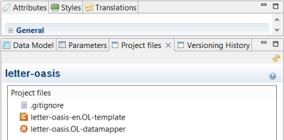

Use the Project Files option in the Project menu to display the list of resources in the project.
The files comprising a Project display in the Project Files panel.

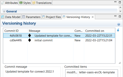

Use the Versioning History option in the Project menu to display the history of all changes. The Versioning History panel contains a complete record of who did what, on which date, and for which reason.
You can elect to revert to a version from within the history if something turns out to be flawed in your current project.
