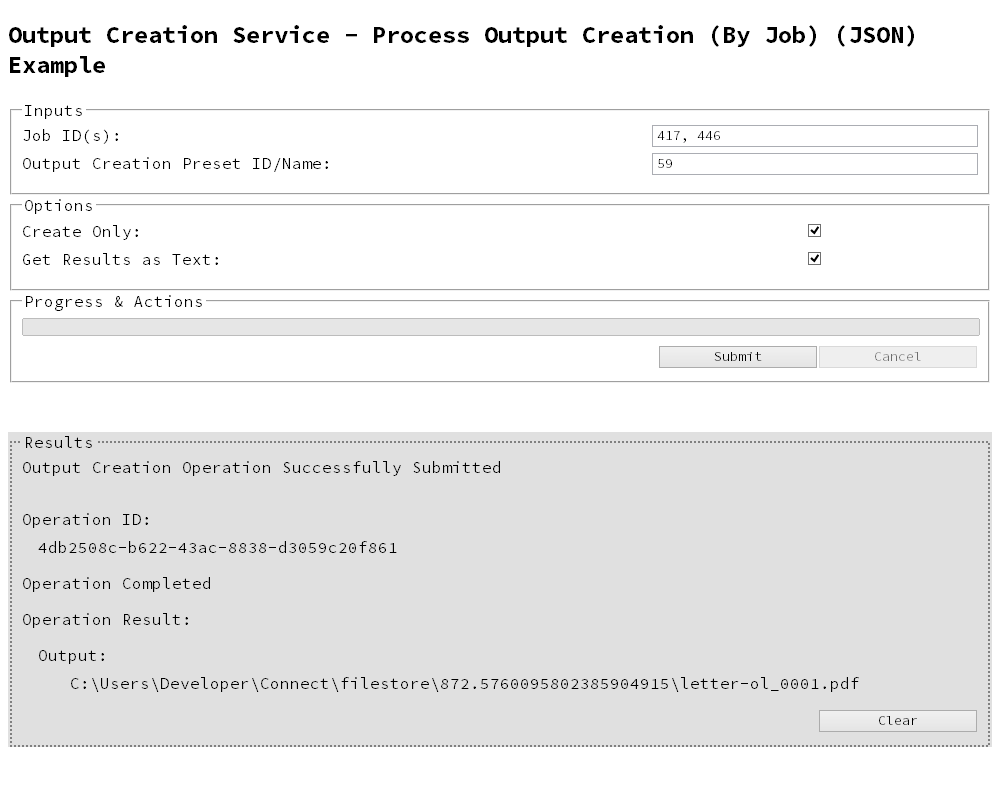

To run the example simply enter a comma delimited list of your Job IDs and the Managed File ID or Name of your output creation preset (previously uploaded to the file store) into the appropriate text fields, and then check any options that you may require:
  • Create Only - Create the output in server but do not send spool file to its final destination. In this example this would mean that the output files(s) would not be sent to the output directory specified in the output creation preset.
  • Get Results as Text - Return the result as text specifically. In this example this would return the absolute path to the output file(s).
Lastly, select the Submit button to start the Output creation operation.
The progress of the operation will be displayed in the progress bar, and once the output creation operation has completed, the output result will be returned and displayed to the Results area.
If the result returned is expected to be file data, then the value <<OCTET-STREAM FILE DATA>> will be displayed.
