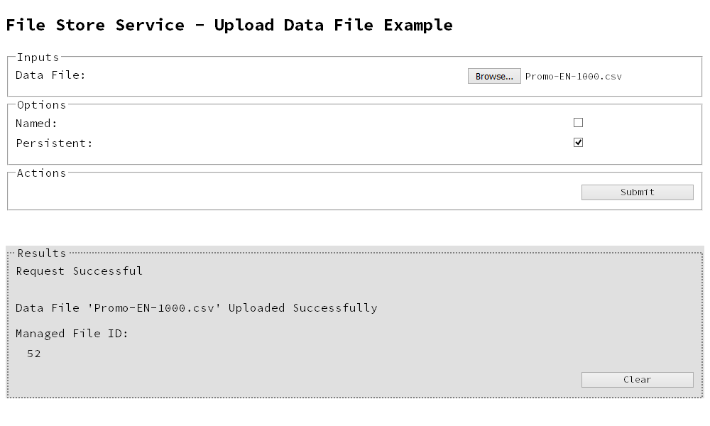

Screenshot & Output
Usage
To run the example simply select the Browse button and then select the data file you wish to upload using the selection dialog box.
Next you can specify the following options to use with the upload of the data file:
  • Named - allow this file to be identified/referenced by its Managed File Name as well as its Managed File ID
  • Persistent - make this file persistent in the file store
Once the file and options are selected, simply select the Submit button to upload the file to the server's file store and the resulting Managed File ID for the data file will be returned and displayed to the Results area.
